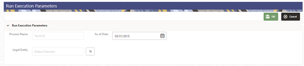

    Figure 2-19 Run Execution Parameters
  4. Select As-of-Date (to indicate the date on which you want to execute the Cash Flow Process) and Legal Entity. By default, these two parameters are picked from the Application Preferences. However, you can change them while submitting the process for execution.
  5. Click OK.
    A confirmation window displays a message Process triggered with execution ID XXXXXXXX. This execution ID can be used to track the status of this process in the Batch Monitoring UI. For more details, see the Monitor Batch section.

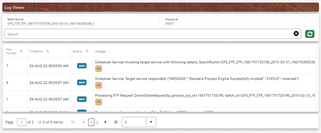

  7. Click on the Actions Icon and select Execution Logs.
    A Log Viewer Window is displayed. You can review any processing errors or alerts related to this process.
    Figure 2-20 Log Viewer
    Log Viewer
  8. Select the Task ID (also known as the Unique System Identifier) to view a report for any processing errors.
    If significant processing errors exist, you should re-run your process.
