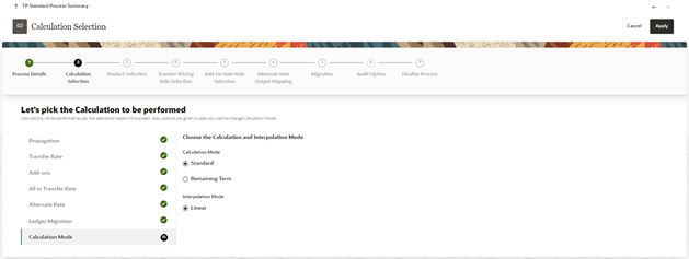

After you select Choose if you want to Customize your Calculation Selections? and click Let’s Start, Guided process set up will get initiated and Process Details Screen is displayed.
  1. Enter the relevant details. For more information, see the Process Details Section.
  2. Click Apply to display the Calculation Selection Screen.
  3. Select the relevant details for the Calculation. For more information, see the Calculation Selection Section.
    Figure 2-18 Sample Train that displays additional Screens
  4. Select the relevant options for Calculation from the available list. For more information, see the Calculation Selection Section.
