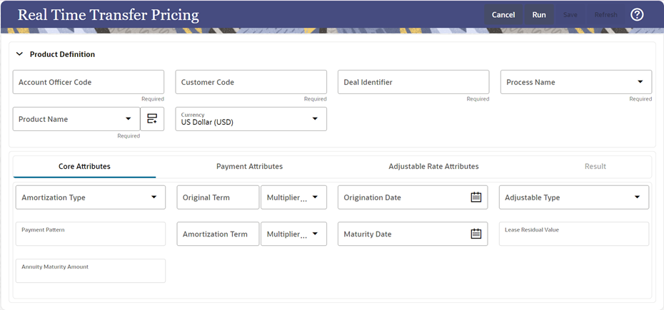

6.4.1 Adding a new Product Definition
To add a new product definition:
  1. Click the Add button on the Real Time Transfer Pricing summary screen.
    Figure 6-7 Product Definition screen
  2. Enter or select the following details:
    • Account Officer Code
    • Customer Code
    • Deal Identifier
    • Process Name
    • Product Name
    • Currency
  3. Under the Core Attributes tab, enter or select the relevant details.
  4. Under the Payment Attributes tab, enter or select the relevant details.
  5. Under the Adjustable Rate Attributes tab, enter or select the relevant details.
  6. Click Run.
  7. Select the As of Date and click Confirm.
    The process generates a Request ID for the product definition.
  8. If you want to see the results, click Refresh.
    The process enables the Results tab and displays the pricing details.
  9. If you want to save the details, then click Save.
    Alternatively, you can go back to Core Attributes tab and modify the values. After modifying, your can follow steps from 6 to 9 once again to see the updated inputs.
    And if all the relevant details are found, the FTP engine starts the transfer pricing process
