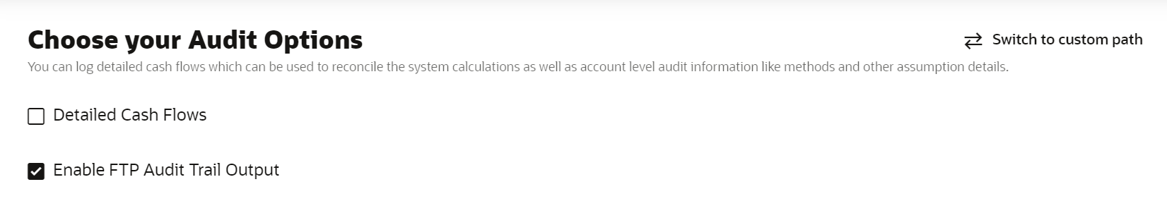

5.3.9.3.10 Audit Option
Figure 5-128 Audit Option
Audit Option
Within the Audit Options screen, you can choose to log the detailed Cash Flows. Later you can retrieve Cash Flows from the FTP_O_CASH_FLOW_OUTPUT_HIST table.
In addition, the Enable FTP Audit Trail Output option allows you to capture the audit details in FTP_O_ENGINE_AUDIT_TRAIL_AGGR table.
In the Audit table, FTPCS provides the method codes to get the method name, and the user need to refer the following tables:
  • FSI_CALC_METHOD_MLS -> Transfer Pricing Method (TP_METHD_CD)
  • FSI_ADJUSTMENT_METHOD_MLS -> Add-On Rate Method
    (LIQ_ADD_ON_METHOD_CD,BASIS_ADD_ON_METHOD_CD,OTHER_ADD_ON_METHOD_CD,PRICING_ADD_ON_METHOD_CD)
