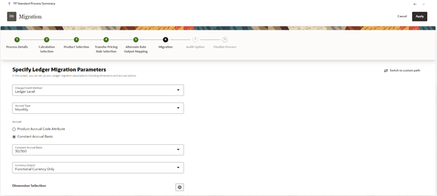

Figure 5-127 Migration
Migration
  1. Within the Transfer Pricing Process definition screen, on the "Migration" block, you can select from the following options for the Charge/Credit Method:
    • Account Level
    • Ledger Level
    The Account Level method will sum the charge / credit amounts computed at the individual instrument level (based on the instrument's current or average book balances) and will group the results by the set of selected dimensions and migrate the amounts, together with the weighted average transfer rates to the Management Ledger table.
    The Ledger Level method will compute the weighted average transfer rates from the instrument data and will migrate these values to the Management Ledger table. The migration process will then multiply the weighted average transfer rates by the Ending or Average balances on the Management Ledger table to arrive at the TP charge or credit amounts.

  2. TP Application Preferences. Choices include Average Balance, Ending Balance or Other Balance.
  3. Oracle Funds Transfer Pricing Cloud Service offers the following accrual basis options:
    • 30/360: This is the default Charge/Credit Accrual Basis option. It applies the accrual basis calculation of 30 days divided by 360 days.
    • Actual/360: Applies the accrual basis calculation of number of days in the month divided by 360 days.
    • Actual/Actual: Applies the accrual basis calculation of number of days in the month divided by number of days in the year.
    • 30/365: Applies the accrual basis calculation of 30 days divided by the 365 days.
    • 30/Actual: Applies the accrual basis calculation of 30 days divided by the number of days in the year.
    • Actual/365: Applies the accrual basis calculation of number of days in the month divided by 365 days.
    • Business/252: Applies the accrual basis calculation of number of business days in the month divided by 252 days. A Holiday calendar selection is required if business/252 accrual basis is selected. If the holiday calendar is not selected, the engine considers Accrual type ACT/ACT as a default for calculation.
  4. A migration block parameter, it allows you to select the output currency. Oracle Funds Transfer Pricing offers you the following currency output options:
    • Entered and Functional Currency
    • Functional Currency Only
      For example, a bank's loan may have Yen as entered currency. However, the bank might use US Dollar to display its consolidated annual results. In this case, US Dollar is the functional currency. In other words, the currency in which an organization keeps its books is its functional currency.
  5. Click Apply to navigate to the next screen.
