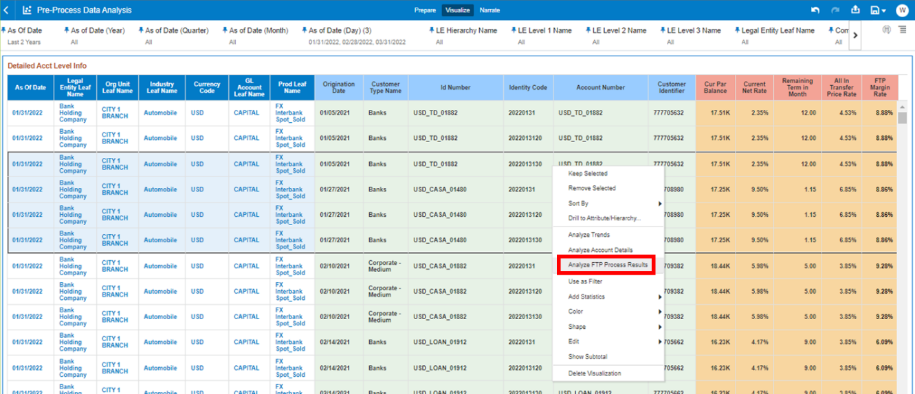

From the “Detailed Acct Level Info” report canvas, you can select a combination of values in the available chart, and then perform the navigation to the Process Results Data Analysis report.
To do so, with a right-click on the chart selection, the Data Action options will appear for you to be able to navigate further as described in the following mapping:
- Analyze FTP Process Results – the Data Action will be drilling through the “Process Results Data Analysis” report.
The following screenshots show the Data Actions list as well as the navigation options that appears once you right-click on the desired selection (for both drill-down and drill-through Data Actions).
