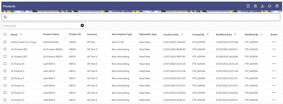

Product setup allows Administrators to define the default Product Characteristics for standard products. The Administrator will define these assumptions for Products during the application setup through the provided user interface.
The Products window shows the list of all the defined Product Characteristics for standard products and you can define/edit the properties for these standard products.

Figure 6-158 Products screen

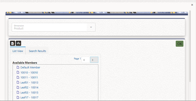

- Select a standard Product using the hierarchy Browser.
Figure 6-160 Hierarchy screen

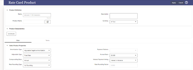

- Define the properties of the Product in the Main tab.
Figure 6-161 Product Definition – Main Tab

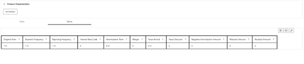

- Define the properties of the Product in the Terms tab.
Figure 6-162 Product Definition – Terms Tab
Under a single product/currency selection, users may define multiple combinations of Original Term, Payment Frequency, and Repricing Frequency. This is done by adding records using the "+" icon. Multiple records are useful when generating daily pricing sheets, where the standard product has multiple terms. For example, the product could be "Term Deposits", but users may want to view the daily FTP Rates for each available term, for example, 3 months, 6 months, 12 months, 18 months, and 60 months. This example is possible by adding and defining multiple records under a single product/currency selection. For more information on the meaning of each of these fields, see the OFS Cash Flow Engine Reference Guide. - Click Apply.
