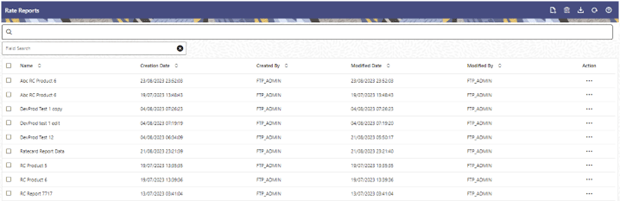

The Rate Report Summary page displays all the existing Rate Reports.

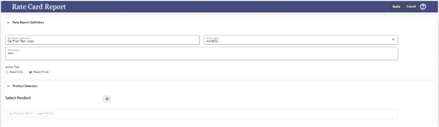

    Figure 6-164 Rate Report – Definition Mode
    This screen allows you to create a new Rate Report.
    This table describes the key terms used for this procedure.
    Table 6-44 Fields and Descriptions from the Rate Report page
    Term Definition
    Rate Report Definition Enter the Rate Report name.
    Description Enter the description of the Rate Report.
    Folder Name Select the Folder name.
    Access Type Select the Access type of Rate Report as Read/Write or Read Only.
    Product Selection Click the Product Mapping (Add) icon to select the relevant standard products to be included in your pricing report.

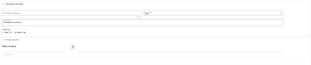

    Figure 6-165 Rate Report – Definition Mode

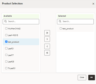

  3. Select the Product(s) from the hierarchy browser using the Add icon. This hierarchy browser will have the list of defined standard products (as set up by the Administrator).
    Figure 6-166 Product Selection – Hierarchy Browser
    This Hierarchy Browser allows you to select the product for the Rate Report.

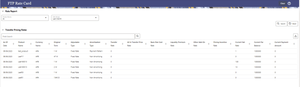

Viewing Rate Card Report
Rate Card report is available upon successful completion of the Pricing Run.
To access a Rate Card Report, select the Rate Report Name and click Report from the Action menu.
Figure 6-167 Rate Report
Rate Report displays the Rate Report Definition.
