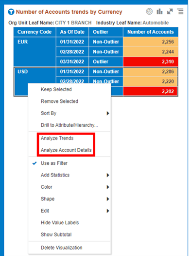

The Data Actions provide the capability to perform both drill-down analysis across the downstream report canvases as well as drill-though navigation to the Process Results Data Analysis report. The drill-down and the drill-through are enabled using three Data Actions.
From every chart available in the report, you can select a combination of values, and then perform the navigation to the other Report canvases.
To do so, with a right-click on the chart selection, the Data Action options will appear for you to be able to navigate further as described in the following mapping:
  • Analyze Trends – the Data Action will be drilling through the “Analyze Trends” canvas.
  • Analyze Account Details – the Data Action will be drilling through the “Analyze Account Details” canvas.

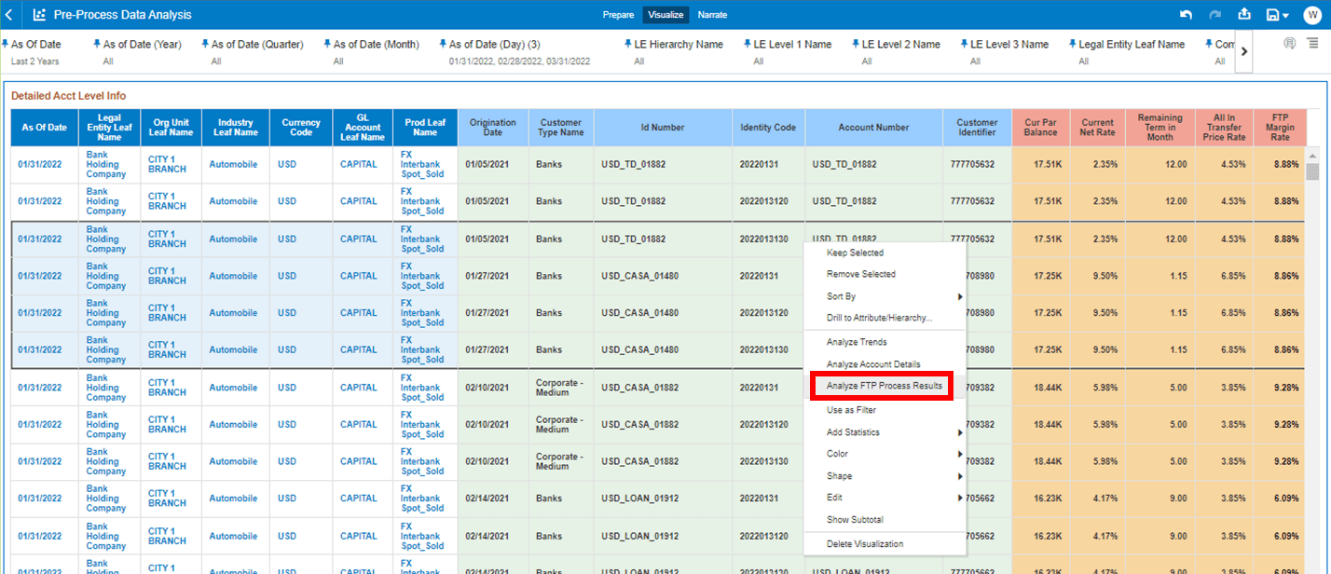

From the “Detailed Acct Level Info” report canvas, you can select a combination of values in the available chart, and then perform the navigation to the Process Results Data Analysis report.
  • Analyze FTP Process Results – the Data Action will be drilling through the “Process Results Data Analysis” report.
The following screenshots show the Data Actions list as well as the navigation options that appears once you right-click on the desired selection (for both drill-down and drill-through Data Actions).

Figure 8-116 Data Action for Drill-down with Report Canvases
Figure 8-117 Data Action for Drill-through to another Report
