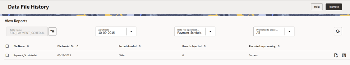

  1. Navigate to the Data Management Tools, select Data File Administration, and then select Data File History to display the Data File History summary screen.
    Figure 3-17 Data File History summary page
    The Data File History summary screen displays the details of the data files. This screen also allows you to search data files, move data files from stage to processing tables, and delete data files from the stage and processing tables.
    The summary screen displays the following information of the data files:
    • Batch Run ID: The ID used to run the batch.
    • File Name: The data file name.
    • File Loaded On: The date on which the data file is loaded.
    • Records Loaded: The number of records loaded using the data file.
    • Records Rejected: The number of records that are rejected from the data file.
    • View Details (Icon): Select a Batch Run ID and click the details of the data file.

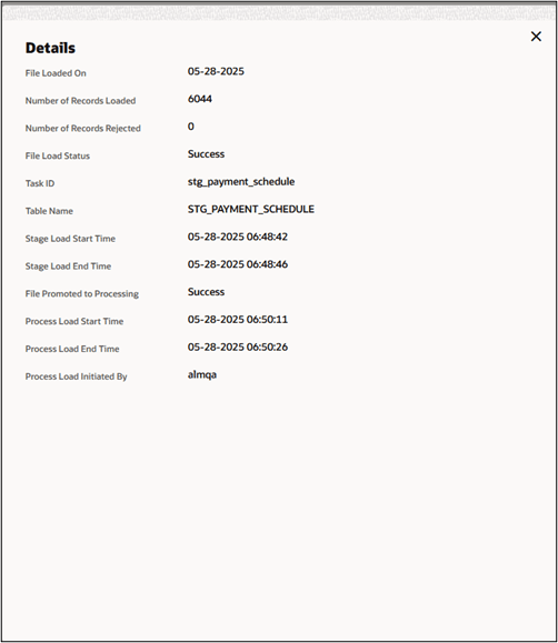

    The following illustration is a sample of the data file’s details.
    Figure 3-18 File Details
    This illustration displays the details of the selected data file.
