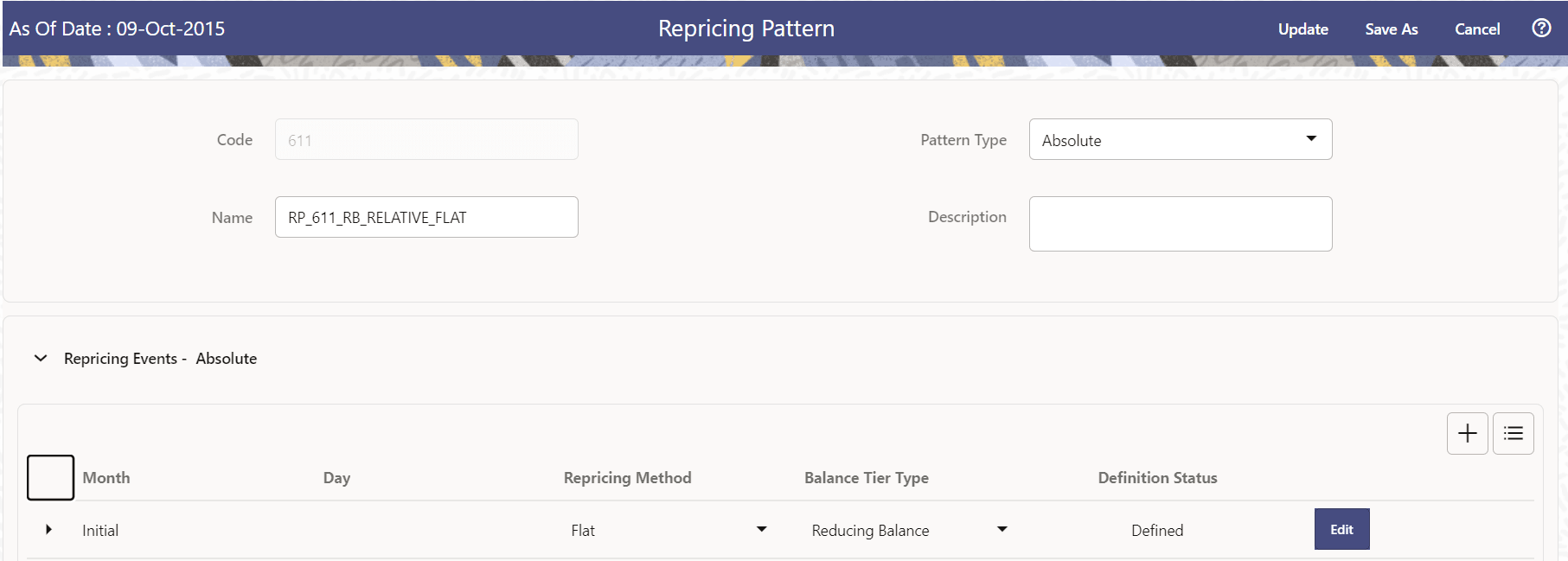

6.1.5.1.1 Define Absolute Repricing Patterns
The Absolute Repricing Pattern is used for instruments that are date dependent. Each specific date is a separate event. You need to enter the month and day for each event, except for the initial event.
Figure 6-18 Define Absolute Repricing Pattern

To define Absolute Repricing Pattern, perform the following:
  1. Select Pattern Type as Absolute.
  2. Specify the required month-day combination for the event. You cannot specify a month-day combination for the first event as this row is reserved for the initial period.
  3. Select the Repricing Type: Flat or Indexed.
    The default is flat. If you select Indexed, the system automatically changes the fields available for entry.
    You can change your selection of the Repricing Type at any point in this process. Sometimes it may cause a loss of data.
    For more information on Flat Repricing Type, see Repricing Event is Flat Repricing.
    For more information on Index Repricing Type, see Repricing Event is Index Repricing.
    • Select Balance Tier option:
      • None: If selected, the Balance Tiered Pricing is not applied.
      • Current Balance: Users can define balance tiers and associate different rates with the corresponding balance tier level. Balance tier in this case is decided using the principal balance of instrument on As of Date. Thus, even when actual balance goes down due to repayment, the instrument continues to be in original balance tier.
      • Reducing Balance: If the Balance Type is selected as Reducing Balance, then the repricing rate will be calculated using principal balance as on Repricing Date. Thus, the balance tier applicable to instrument range over its life due to repayment.
  4. Click Define.
