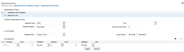

11.4.1.1 Adjustment - Fixed Rate
Figure 11-20 Adjustment Rule Details
This illustration is the Adjustment Rule (Definition Mode) that allows you to define the Adjustment Rule Details.
The Fixed Amount Adjustment method allows the user to associate an amount with specific terms or term ranges. Reference term selections include the following:
