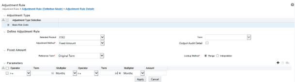

11.4.1.2 Adjustment - Fixed Amount
Figure 11-21 Adjustment Rule Details
This illustration is the Adjustment Rule (Definition Mode) that allows you to define the Adjustment Rule Details.
The Fixed Amount Adjustment method allows the user to associate an amount with specific terms or term ranges. Reference term selections include the following:

You can create your reference term ranges and assign a particular adjustment amount to all instruments with a reference term falling within the specified range.
  • Holiday Calendar: Select if a holiday calendar is applicable for calculating the charges/credits.
  • Rolling Convention: Select the appropriate business day rolling convention if a Holiday Calendar is selected.
  • Interest Calculation logic: Select the appropriate option to indicate how the interest payment should be adjusted when a holiday date is encountered.
All adjustment amounts should be input in base currency for the selected product/currency combination.
