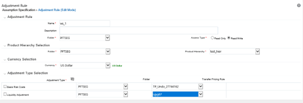

    1. Navigate to the Adjustments Assumption browser page.
      Figure 27-4 Adjustment Rule - Edit Mode
      This screen allows you to edit an existing Adjustment Rule.
    2. Select an appropriate Adjustment Type: Liquidity Adjustment, Basis Risk Costs, Pricing Incentives, Other Adjustment, or Breakage Charge by opening the Adjustment Type Selector Window. You can enable one or more Adjustment Types within a single Adjustment Rule and apply more than one Adjustment to a single product.
