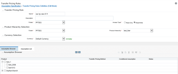

To define assumptions for the Default Currency, select a Product from the Hierarchy and “Default Currency” from the currency list and proceed with the assumption definition as described above. When processing data, the TP engine will first look for an assumption that exactly matches the product/currency of the Instrument Record. If not found, the engine will then look for the combination of the product and the Default Currency. This is a useful option to utilize during setup when the same product exists across multiple currencies and shares the same TP assumption and Interest Rate Code.
Figure 27-6 Adjustment Rule Definition with Default Currency
This screen allows you to edit an Adjustment Rule Definition with Default Currency.
