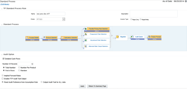

The checkbox Implied Forward Rates will be active only when:
  • The Forward Transfer Rate option is selected on the Calculation Selection block.
  • The Detailed Cash Flows checkbox is selected in the Audit block.
Figure 33-7 Standard Process
This screen allows you to execute a standard process.
