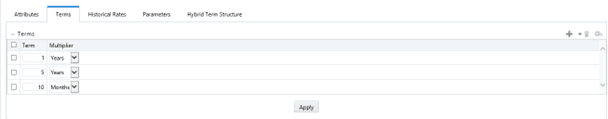

- Terms tab - Contract Term: Add rows and input terms for the
number of required Loan Terms. These are the maturity term of the loan. Select
APPLY to save the data.
Figure 32-4 Terms Tab – Contract Term

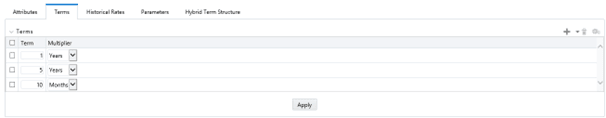

- Terms Tab – Expiration Term: Add rows and Input Terms for the
number of required Expiration Terms. These correspond to the number of Rate Lock
Terms offered. Select APPLY to save the data.
Figure 32-5 Terms Tab – Expiration Term

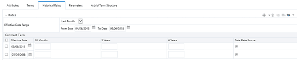

- Historical Rates tab: After defining and applying the
volatility curve dimensions, navigate to the Historical Rates tab and input the
volatility rates for each combination of the loan term and rate lock term and for
each effective date that you wish to store historical volatility data.
Figure 32-6 Historical Rates tab
Select Apply when finished to save the data.
