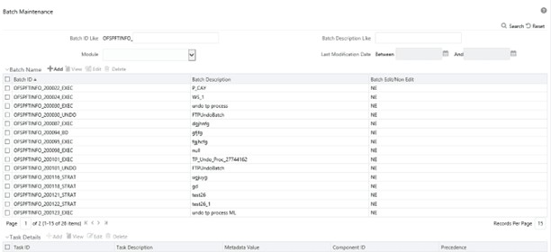

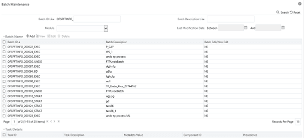

  1. Click the Batch Maintenance option under Operations.
    Figure 33-7 Batch Maintenance screen
    The Batch Maintenance screen displays the list of batches.
  2. Click the Add icon to create a Batch for running the daily FTP process against standard products.
  3. Enter the Batch Name and description. Select the Duplicate Batch and/or Sequential Batch option(s) if required. Click Save to save Batch details.

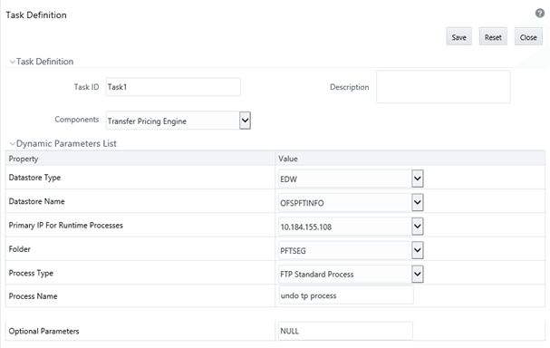

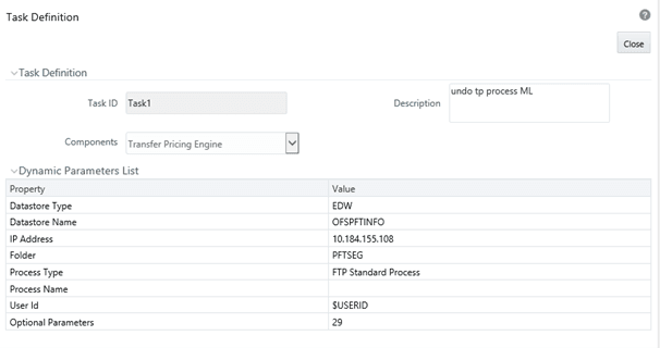

  7. Click Add to add the second task to the selected Batch and enter the description for the second task on the Task Definition page. Select the component of the task as "Transfer Pricing Engine". This process will execute a TP engine Run, reading the instrument data from the FSI_PM_GENERATED_INSTRMTS table and will update the Transfer Rate column with the calculated result.
    Users must first create a Standard TP Process for selection in this batch. The TP Process should include the “PM Generated Instruments” table under Source Selection. The calculated items should include all relevant rate calculations, such as Transfer Rate and Adjustment Rates.
  8. Enter the required parameters as follows:
    • Folder: Select the folder in which the definition of the process that has to be scheduled for execution is lying.
    • Process Type: The Process type can be Standard or Stochastic.
    • Process Name: The Process Name should be defined for process metadata value (system ID of the process) which is defined in Task 1 under Executable parameter.

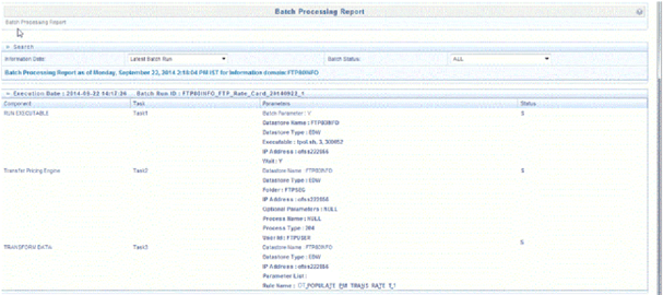

  15. To view the Batch Processing Report, click the Batch Processing Report option under Operations. Expand the Execution Date.
    Figure 33-14 Batch Processing Report
    The Batch Processing Report displays the details of the processed batches.
    At this point, “dummy” instrument records will be generated, the records will be transfer priced, inclusive of both base TP Rates and any Add-on Rates defined through an Adjustment Rule, and the results will be moved into the Rate Card reporting table and will be available for reporting.
