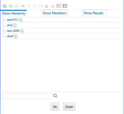

  1. Select a standard Product using the hierarchy Browser.
    Figure 33-3 Hierarchy screen
    The Hierarchy screen allows you to select the product hierarchy.

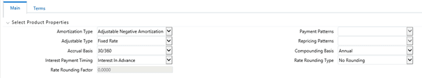

  3. Define the properties of the Product in the Main tab.
    Figure 33-4 Product Definition – Main Tab
    The Product Definition Main tab allows you to select the Product Properties.

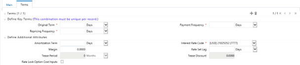

  4. Define the properties of the Product in the Terms tab.
    Figure 33-5 Product Definition – Terms Tab
    The Product Definition – Terms Tab allows you to enter and select the Terms for the product.
    Under a single product/currency selection, users may define multiple combinations of Original Term, Payment Frequency, and Repricing Frequency. This is done by adding records using the "+" icon. Multiple records are useful when generating daily pricing sheets, where the standard product has multiple terms. For example, the product could be "Term Deposits", but users may want to view the daily FTP Rates for each available term, for example, 3 months, 6 months, 12 months, 18 months, and 60 months. This example is possible by adding and defining 5 records under a single product/currency selection. For more information on the meaning of each of these fields, see the OFS Cash Flow Engine Reference Guide.
