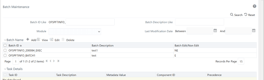

  1. Click the Batch Maintenance option under Operations.
    Figure 11-27 Batch Maintenance page
    The Batch Maintenance screen allows you to create a batch to delete the records from the FSI_O_FTP_ADJ_TP_VALUES table.
  2. Click the Add icon to create a Batch for deleting records from the FSI_O_FTP_ADJ_TP_VALUES table.
  3. Enter the Batch Name and Description. Select the Duplicate Batch and Sequential Batch, or Duplicate Batch or Sequential Batch options if required. Click Save.
  4. Search the created Batch using the Search criteria if required. The Batch is displayed. Select the Batch to add the corresponding task to it.

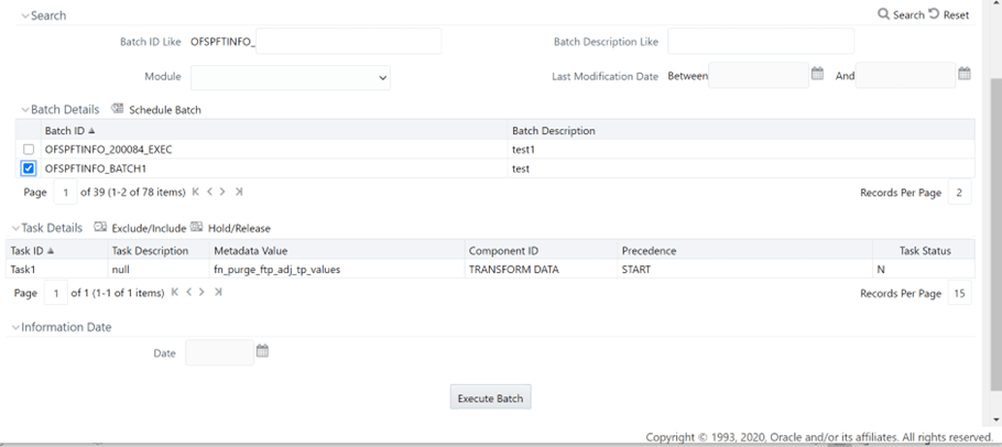

  6. To execute the Batch, click the Batch Execution option under Operations. Select the Batch, which you want to execute using the search criteria. Select the Batch using the corresponding check box.
    Figure 11-28 Batch Search page
    This screen allows you to search and execute a batch.
  7. You can also use the Schedule option if you want to schedule a Batch for later or recurring processing. Click Execute Batch. A message is displayed: Batch Triggered Successfully. Click Ok.

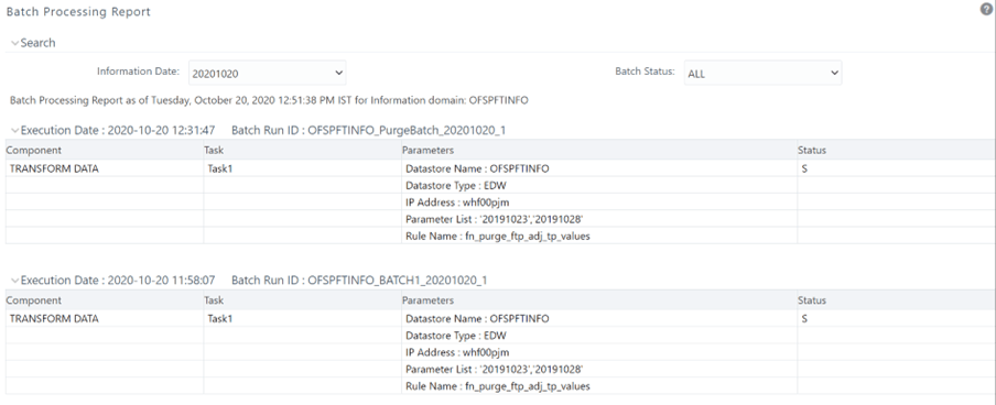

  8. To view the Batch Processing Report, click the Batch Processing Report option under. Expand the Execution Date.
    Figure 11-29 Batch Processing Report
    This report displays the details of the processed batch.
