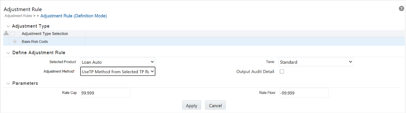

Figure 11-25 Adjustment Rule (Edit Mode)
This screen allows you to edit the parameters that are defined earlier for the Adjustment Rule. Also, you can define the Product Hierarchy Selection, Currency Selection, and Adjustment Type Selection.
Figure 11-26 Adjustment Rule Details - TP Method
You can attache any Transfer Pricing Rule on this screen separately for each type of add-on-rate. The TP Methods mapped to product hierarchy members in the TP Rule will be read during the adjustment rate calculation process and applied during the calculation of the Adjustment Rate(s). Outputs will be written to the respective Adjustment Rate column, for example, Basis Risk Cost Rate, Liquidity Premium Rate, Pricing Incentive Rate, or Other Adjustment Rate.
Users can attach any Transfer Pricing Rule on the Adjustment Rule summary page separately for each type of add-on rate. The TP Methods mapped to product hierarchy members in the TP Rule will be read during the adjustment rate calculation process and applied during the calculation of the Adjustment Rate(s). Outputs will be written to the respective Adjustment Rate column, for example, Basis Risk Cost Rate, Liquidity Premium Rate, Pricing Incentive Rate, or Other Adjustment Rate.
