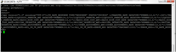

This screenshot illustrates how the web service call is made and what the return information looks like when running from the command line.
Example: java -jar FTPWSClient.jar Request.json <Restful_URL>
"TP" in the above command indicates you are calling the getTPRate program for this web service. A value of "EC" would indicate you are calling the getEconomicCost program.
Figure L-1 Putty Snapshot
Putty Snapshot
