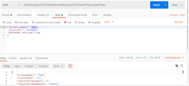

L.6.2 Test using Web API Testing Tool (example Postman)
To test using the Web API Testing Tool (example Postman), follow these steps:
  1. Create a new request from the tool's New Menu.
  2. Select the request type as POST.
  3. Enter the FTP Rest services URL.
  4. In the headers section set the 'Content-Type= application/JSON'.
  5. We have detailed the request JSON format for all the web services.
  6. Create the JSON in the required format.
  7. Copy the JSON and paste it in the Body's raw section of the tool.
  8. Press the send button.
  9. The request is submitted to the requested web service.
  10. The service is invoked on the server and the requested/calculated values are shown in the response section of the tool.
  11. The following image shows the above steps:
Figure L-2 Web API Testing Tool
