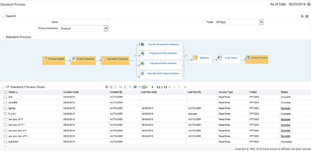

Figure 31-1 Transfer Pricing - Standard Process
This screen allows you to select the Standard Process for Transfer Pricing.
