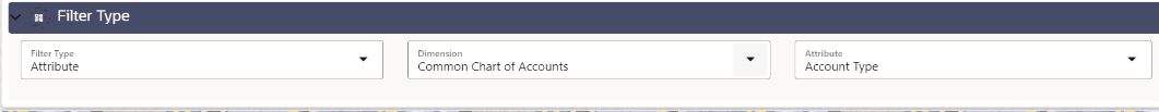

When you have selected the Filter Type as Attribute, define the Filter conditions by doing the following in the Attribute Selection Section:
Figure 12-5 Attribute Filter Type Selection
  1. Select the required Dimension from the drop-down list.
  2. Select the associated Attribute from the drop-down list.
    The list consists of only Dimension Type attributes for selection.
    The Attribute Values pane displayed.
