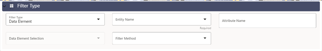

When you have selected the Filter Type as Data Element, define the Filter conditions by doing the following in the Data Element Selection Section:
Figure 12-4 Data Element Filter Type Selection
  1. Select the required database table from the Entity Name drop-down list.
    The associated members are displayed in the Show Members Section.
  2. Select the associated Attribute Name from the drop-down list.
    The Attribute Name is based in the selected Database Table.
  3. Select the Data Element from the drop-down list.
    This is based on the selected Entity and Attribute.
