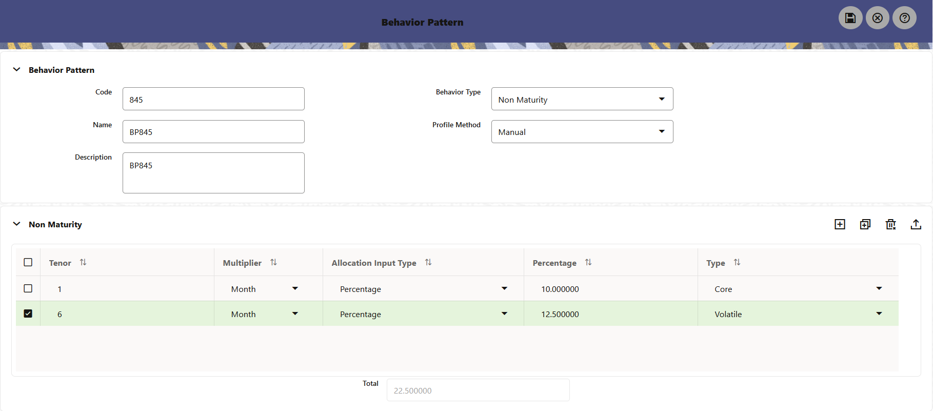

  1. In the Behavior Pattern Details Page, select Non Maturity as the Behavior Pattern Type.
  2. Select Non-Maturity Products Profile Method as Manual.
  3. Enter or select the following details:

  8. Click Save.
Figure 16-4 Behavior Pattern Type as Non-Maturity
The Behavior Pattern is saved and the Behavior Pattern Summary Page is displayed.
