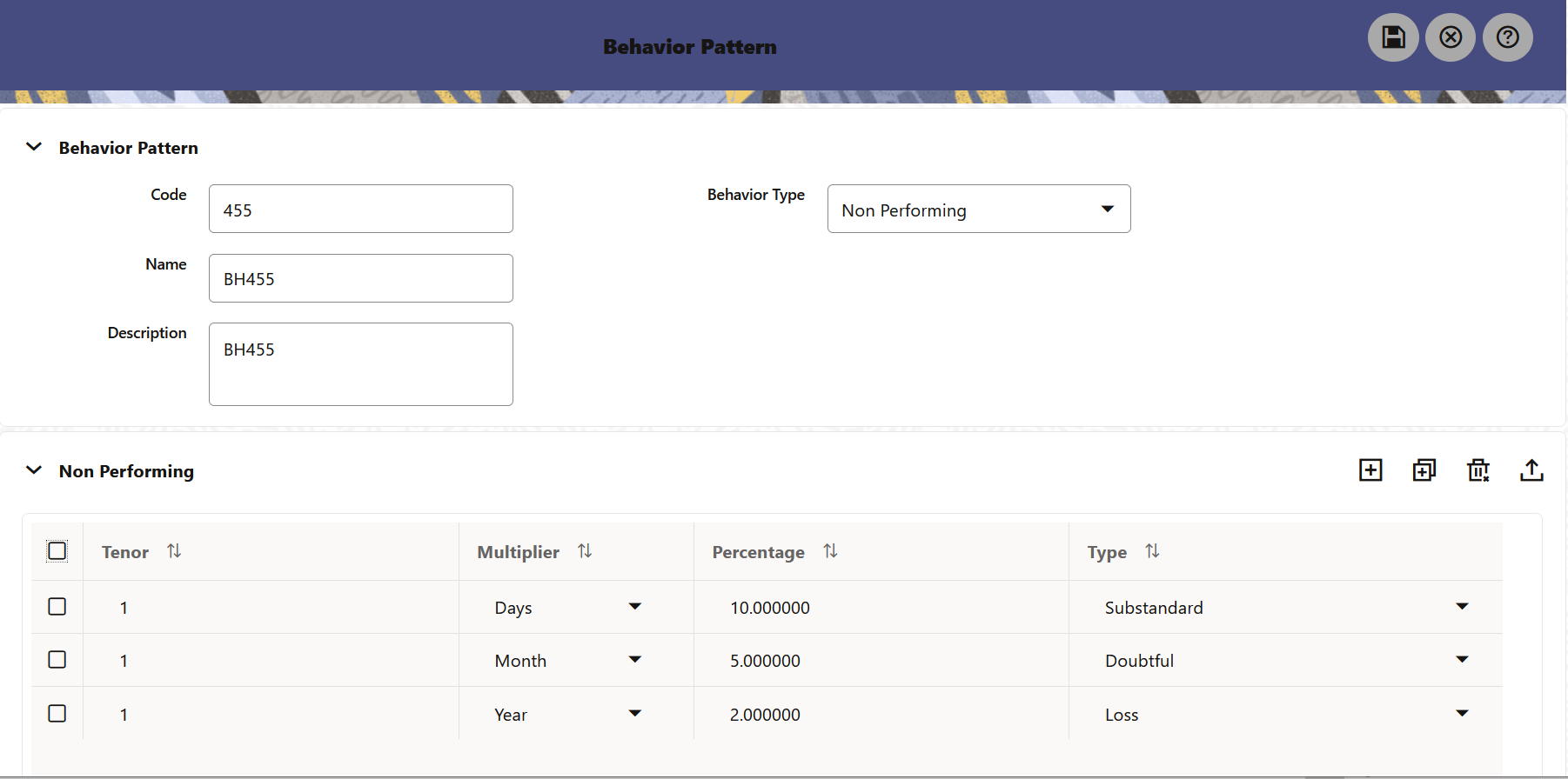

  1. In the Behavior Pattern Details Page, select Non-Performing as the Behavior Pattern Type.
  2. Click the Add icon to open the Non-Performing Behavior Patterns Summary Page.
    Figure 16-5 Behavior Pattern with Type as Non-Performing
  3. Enter or select the following details:

  4. Click the Add icon to add additional payment strips to the Pattern and define appropriate assumptions for each strip.
  5. To delete a row, select the check box corresponding to the row(s) you want to remove and click the Delete icon.
  6. Click Save.
The Behavior Pattern is saved and the Behavior Pattern Summary Page is displayed.
