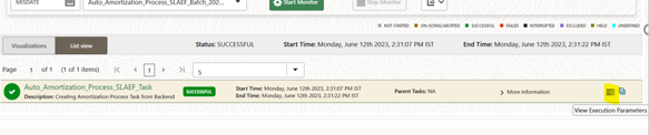

10.1 View the Execution Parameters
Perform the following steps to view the execution parameters:
  1. Navigate to Operations and Processes, select Scheduler, and then select Monitor Batch.
  2. Select Batch and Run Id.
  3. Click Start Monitor.
  4. Click List View Tab.
  5. Click View Execution Logs icon to view Batch Logs.
    Figure 10-2 View Execution Parameter
