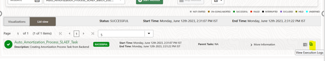

You can view the information about high-level processing steps from User Interface. To view the IFRS 9 S CS Process information, follow these steps:
  1. Navigate to Operations and Processes, select Scheduler, and then select Monitor Batch.
  2. Select Batch and Run Id.
  3. Click Start Monitor.
  4. Click List View tab
  5. Click View Execution Logs icon to view Batch Logs.
    Figure 10-1 View the IFRS 9 S CS Process Information
