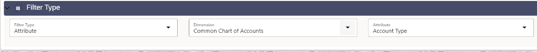

When you have selected the Filter Type as Attribute, define the Filter conditions by doing the following in the Attribute Selection Section:
Figure 4-23 Attribute Filter Type Selection
- Select the required Dimension from the drop-down list.
- Select the associated Attribute from the drop-down list.
The list consists of only Dimension Type attributes for selection.
The Attribute Values pane displayed.
