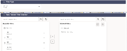

Defining a Group Filter
Group Filters can be used to combine multiple Data Element Filters with a logical "AND".
When you have selected the Filter Type as Group, define the Filter conditions by doing the following in the Group Selection Section:
Figure 4-24 Group Filter Type Selection
  1. Select the checkbox(s) adjacent to the required Data Element Filters in the Available Filters section and click play_icon. The selected filters are displayed in the Selected Filters pane.
    Select the checkbox adjacent to the Data element filter in the Selected Filters pane and click to deselect a filter.
    You can also click the Search button to search for a filter in the Data Element Filter Search dialog using Folder Name and Filter Name.
  2. Click Save ( Save icon) to validate the entries and save the filter details.
