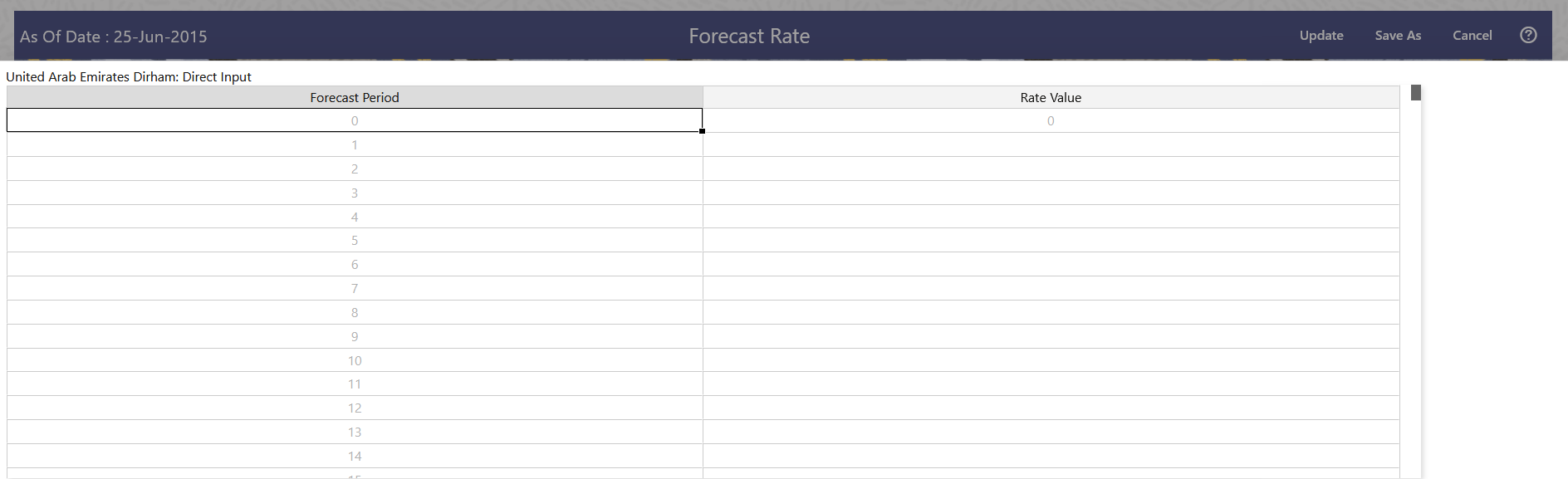

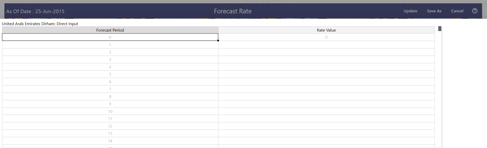

- Direct Input
- Select Currency Code using corresponding checkbox and select Forecast Method as Direct Input.
 - Input Minimum Rate, if required.
 - Click Define. The Direct Input
                        window is displayed:
Figure 4-52 Direct Input window
 - Right click on data grid and select ‘Export to excel’ to save visible data to excel file. You can also copy directly from the grid and paste data from an excel file to the grid. Enter data and click Apply.
 - The status of the Currency Code is changed to Defined.
