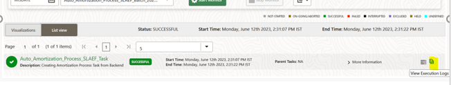

You can view the information about high-level processing steps from User Interface. To view the OFSASBCS Process information, follow these steps:
  1. Navigate to Operations and Processes, select Scheduler, and then select Monitor Batch.
  2. Select Batch and Run Id.
  3. Click Start Monitor.
  4. Click List View tab
  5. Click View Execution Logs icon to view Batch Logs.
    Figure 5-13 View the Process Information
    To view the debug level information, from the Preference screen, select the Debug option from the View Logs Level drop-down list.
