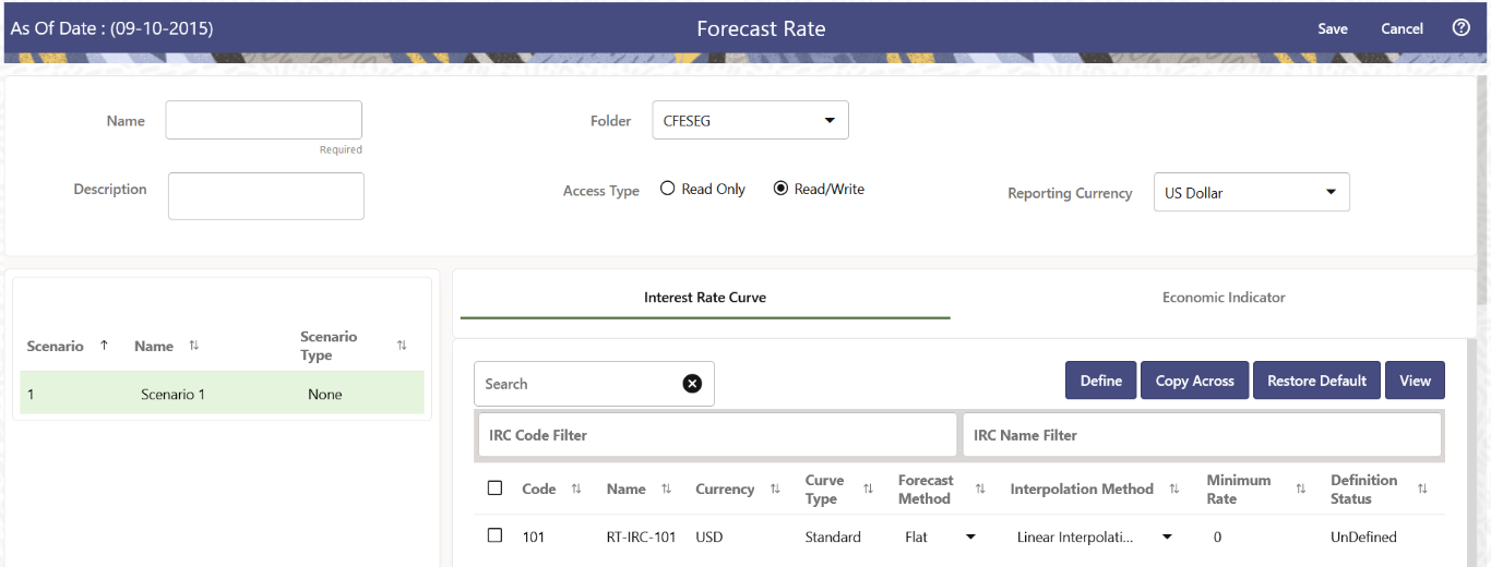

Figure 2-2 Interest Rate Curve Forecast Rates
You can define Interest Rate Forecast for the following methods:

Following options are available for Interest Rate Curve Forecast Rule:
Define
  • Flat Method
    1. Select Interest Rate Code using corresponding checkbox and select Forecast Method as Flat.
    2. Select the Interpolation method.
    3. Input Minimum Rate, if required.
    4. Click Define.
      The status of the Interest Rate Code is changed to Defined.
