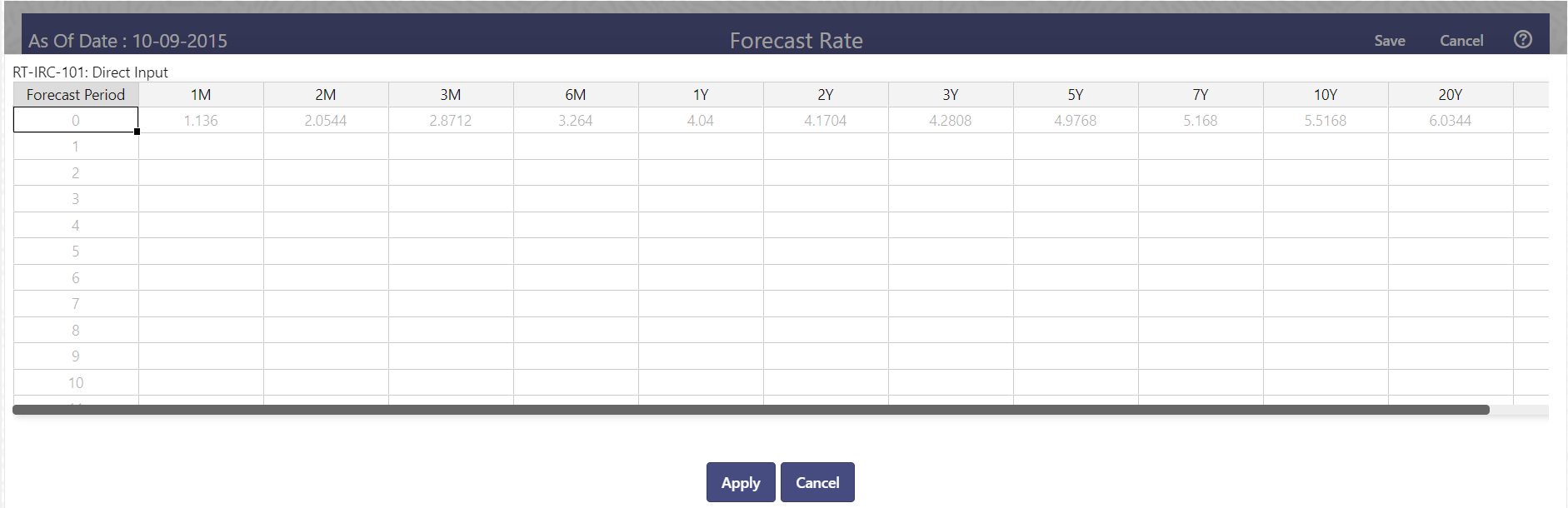

- Direct Input
- Select Interest Rate Curve using corresponding checkbox and select Forecast Method as Direct Input.
- Select the Interpolation Method.
- Input Minimum Rate, if required.
- Click Define.
The Direct Input window is displayed:
Figure 2-3 Direct Input
- Enter data and click Apply. Right click on data grid and select ‘Export to Excel’ to save visible data to excel file. You can also copy directly from the grid and paste data from an excel file to the grid.
- The status of the Interest Rate Curve is changed to Defined.

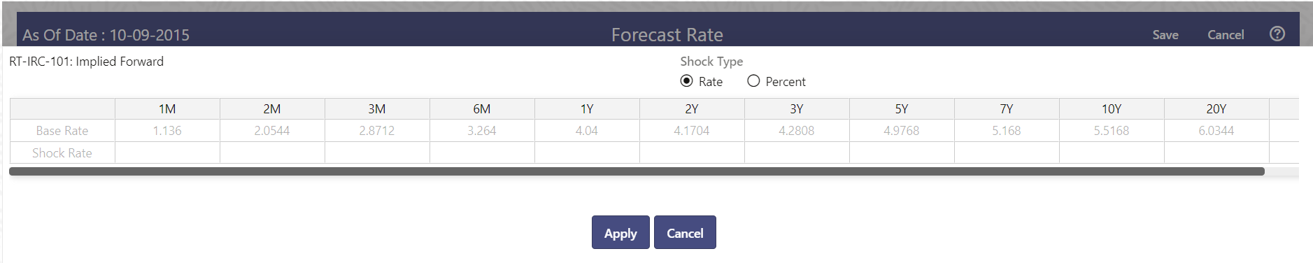

- Implied Forward
- Select Interest Rate Curve using corresponding checkbox and select Forecast Method as Implied Forward.
- Click Define.
The Implied Forward window is displayed:
Figure 2-5 Implied Forward
- Select the Shock Type as Rate or Percent. Shock Type as Rate designates to absolute rate change and Shock Type as Percent designates to percent rate change.
- Enter a shock amount to apply to the IRC in absolute rate or percentage change. If no change is required to the base curve, leave at 0.0, and click Apply.

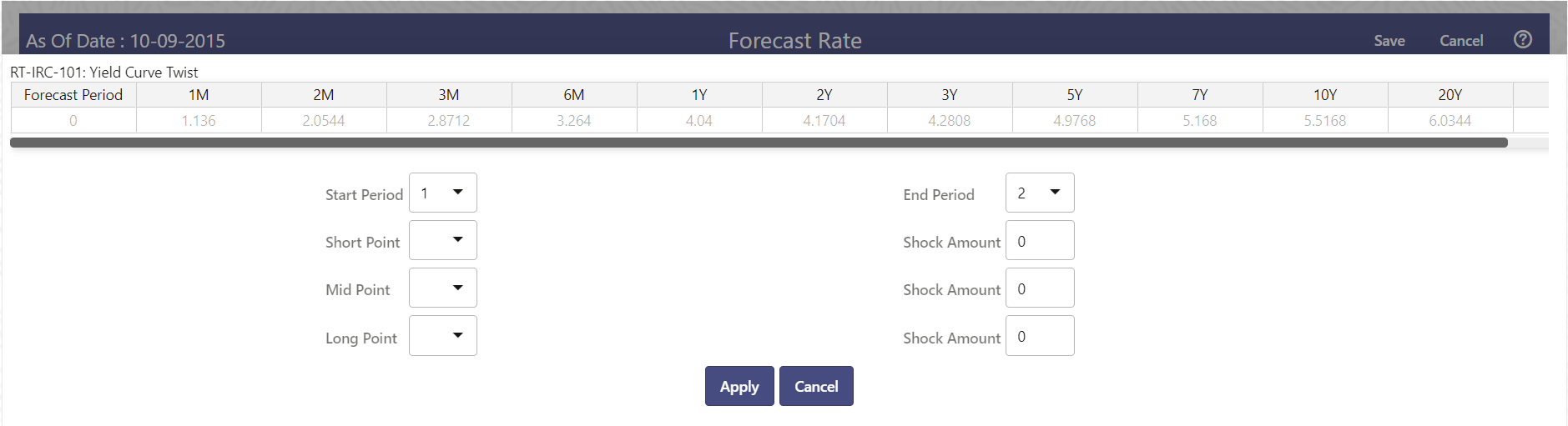

- Yield Curve Twist
- Select Interest Rate Curve using corresponding checkbox and select Forecast Method as Yield Curve Twist.
- Click Define.
The Yield Curve Twist window is displayed:
Figure 2-6 Yield Curve Twist
- Select Start and End Period. Start Period must 1 or higher while highest End Period can be 360.
- Select the tenors using the Short Point, Mid Point, and Long Point.
- Add the required shock amounts for each tenor. At runtime and display time, the rate changes are added to the As-of-Date rates to create a future scenario.
- Click Apply.

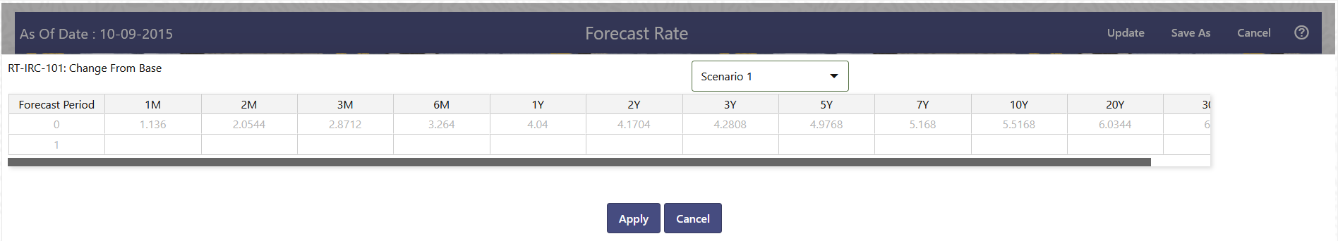

- Change From Base
This method is available from second scenario onwards.- Select Scenario 2 or higher as Scenario.
Figure 2-7 Change From Base
- Select Interest Rate Code using corresponding checkbox and select Forecast Method as Change from Base.
- Click Define. The Change From Base window is displayed.
Figure 2-8 Change From Base
- Scenario 1 is used as base scenario.
- Enter the Forecast Period from 1 to 360 months and the corresponding change amount to apply to the base forecasts IRC. Right click on data grid to all more rows or delete rows. Use the Excel Import or Export feature to add the interest rate changes.

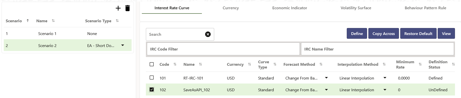

- Standardized Approach Shocks
Standardized Approach shocks are different than other Interest Rate Rules as these are applied at the scenario level instead of at the IRC level. When you create a new Forecast Rates rule, the default Scenario 1 is always the base scenario for Standardized Approach purposes and cannot have a Standardized Approach shock definition.
- In Forecast Rates window, select the IRRBB Shocks. This allows you to define either Standardized or Enhanced Approach Scenarios, or both for a single Forecast Rates Rule. Once a forecast rates rule is designated as IRRBB Shocks, this checkbox cannot be unselected unless there are no defined scenarios as either Standardized or Enhanced Approach scenario type.
- To apply a Standardized Approach scenario, click the Add Scenario.
- In the Add Forecast Rates Scenario section, select the Scenario Type to
apply the scenario. The following are the shock scenarios:
- Standardized Approach Shock - Parallel UP
- Standardized Approach Shock - Parallel DOWN
- Standardized Approach Shock - Short UP
- Standardized Approach Shock - Short DOWN
- Standardized Approach Shock - Flattener
- Standardized Approach Shock - Steppener
- Only one Standardized Approach shock can be applied to a single scenario, and no two SA shocks of the same type may be applied to the same Forecast Rates rule. All qualifying IRCs will inherit this SA shock and cannot be changed except for their interpolation method and minimum rate.
- Click Apply to make scenario as Standardized Approach shock.

- Yield Curve Twist
- Click View to see the Output Table.
- Implied Forward
- Change From Base
- Select Interest Rate Curve using corresponding checkbox and select Forecast Method as Change From Base.
