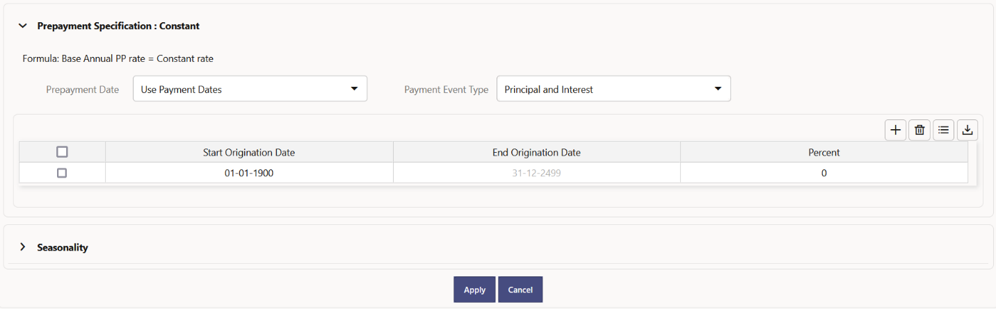

2.2.1.1 Defining Constant Prepayment Method
Use this procedure to define prepayment assumptions using the Constant Prepayment Method. The Constant Prepayment Method calculates the prepayment amount as a flat percentage of the current balance. You can create your own origination date ranges and assign a particular prepayment rate to all the instruments with origination dates within a particular Origination Date range.
Figure 2-6 Constant Prepayment Method
Prerequisites
Performing basic steps for creating or updating a Prepayment Rule.
Procedure
Users also have two options for determining the timing of the Constant Prepayment assumption. The options include:
  • Use Payment Dates: This is the default option. If this option is selected, then Constant Prepay­ment Runoff will occur on scheduled payment dates only.
  • User Defined Prepayment Tenors: If this option is selected, users can specify any runoff timing. For example, users might choose to define the prepayment to the Runoff on the first day of the fore­cast.
The above options will be available only for Asset Instrument types.
To define constant prepayment within the Prepayment Rule, follow the steps given in below sections:
Use Payment Dates
  1. Select the Use Payment Dates Option.
  2. Select the Payment Event Type Option.
  3. Select the Start Origination Date using the date picker. Alternatively, you can enter the Start Origination Date in the space provided.
    The first cell in the Start Origination Date Column and all the cells in the End Origination Date Column are read-only. This ensures that all possible origination dates must support refer­ence values when Prepayment assumption lookups occur.
    Each row in the End Origination Date Column is filled in by the system when you click Add Row or save the Rule.
    The first Start Origination Date (in row 1) has a default value of January 1, 1900. When you enter a Start Origination Date in the next row, the system inserts a date that is a day before the previous End Origination Date Field.
  4. Enter the Annual Prepayment Rate Percent that you want to apply to the instruments having orig­ination dates in a particular Start Origination-End Origination Date range.
  5. The Percent column represents the actual annualized prepayment percentage that the system uses to generate the principal runoff during the Cash Flow calculations.
  6. Click Add Row to add additional rows and click the corresponding Delete button to delete a row.
  7. You can add as many rows as possible in this table using Add Multiple Row Option. However, you need to enter relevant parameters for each new row.
  8. You can also use the Download Excel feature to export the Prepayment rate information that is displayed on screen, modify, and copy-paste it back in the grid.
  9. Define Seasonality assumptions if required to model date-specific adjustments to the annual prepayment rate. Inputs act as a multiplier, For Example, an input of 2 will double the prepayment rate in the indicated month.
