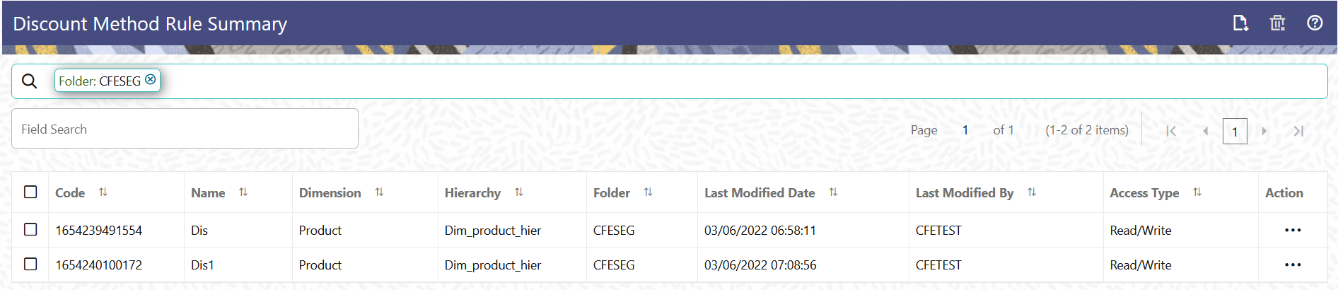

Discount Method Rule Summary
This page is the gateway to all Discount Method Rules and related functionality. You can navigate to other pages relating to Discount Method Rules from this point.
Figure 2-1 Discount Method Rule Summary
Search Discount Method Rule

The Discount Method rule Summary displays the following information:
Add: Click the Add icon on the page header to build a new Discount Method rule.
  • Code: The Code of Discount Method Rule.
  • Name: The Discount Method Rule's short name.
  • Dimension: The Dimension the Discount Method Rule belongs to.
  • Hierarchy: Name of Hierarchy that is used to define Discount Method Rule.
  • Folder: The Folder where the Discount Method Rule is saved.
  • Last Modified By: The user who last modified the Discount Method Rule.
  • Last Modified Date: The Date and Time when the Discount Method Rule was last modified.
  • Access Type: The access type of the rule. It can be Read-Only or Read/Write.
  • Action: Click this icon to view a list of actions that you can perform on the Discount Method rule.
    • Multiple Delete: Enables you to select and delete one or multiple rules in the table simultaneously.
    • View/Edit: Based on the user privilege assigned, you can either only view or edit existing Discount Method rules. To edit a rule, you must have Read/Write privilege.
    • Save As: You can reuse a Discount Method rule by saving it under a new name thus saving time and effort in entering data multiple times; it also leads to reduced data entry errors.
    • Delete: You can delete Discount Method rules that you no longer require. Note that only Discount Method rule owners and those with Read/Write privileges can delete Discount Method rules. A Discount Method rule that has a dependency cannot be deleted.
    • Dependency Check: You can perform a dependency check to know where a particular Discount Method rule has been used. Before deleting a rule, it is always a good practice to do a dependency check to ensure you are not deleting Discount Method rules that have dependencies. . A report of all rules that utilize the selected Discount Method rule is generated.
