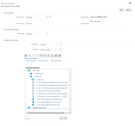

    The Filter Definition window is displayed.
    Figure 7-2 Filter Definition New window
    This illustration shows the Filter Definition New window. The window has panes such as, Filter Details, Filter Type Selection, and Hierarchy Selection. To add the filter, you need to specify the fields in these panes. The description of the fields is provided in the table in the topic.
