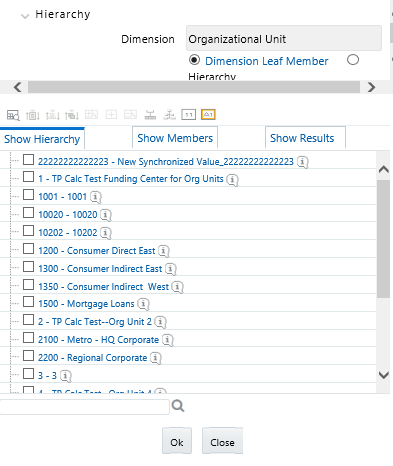

- Click the Hierarchy Browser ellipses (…) that appear next to your Key Leaf. The Hierarchy Browser defaults to a list of leaves for the Key Leaf dimension you have chosen (the radio button selector near the top of the browser window defaults to Dimension Leaf Member). You may scroll up and down to find the leaf member or leaf member you want. You may also search for a dimension member's name (short description) using the binoculars icon at the bottom of the browser window. The Search Control provides additional search functionality within the browser. This additional functionality allows you to search by Dimension Member, Name, or Code. Once you have selected the Key Leaf values you want, click OK.
- You may also define Key Leaf values to be rollup members within a hierarchy. To
select hierarchy rollup point members, click Hierarchy near
the top of the browser window and then search for the hierarchy you wish to use.
After the browser window displays your chosen hierarchy navigate into the hierarchy
until you have found the rollup points you want. Select the value or values you want
and click OK.
Figure 17-4 Hierarchy Selection screen
- After you have clicked OK within the Hierarchy Browser
window, that window closes and you are directed back to the Static Table
Driver Definition tab. If you open the Hierarchy Browser of
dimension, it shows the members as checked, which were already selected while
defining a key leaf.
