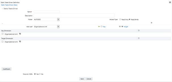

To add a Target Leaf, follow these steps:
- Select the Dimension you want to define as a Target Leaf from the Add Leaf drop-down list.
- Select Target.
- Click Add.
The Target Leaf dimension is added under the Target Dimension section.
Figure 17-5 Static Table Driver Definition screen
