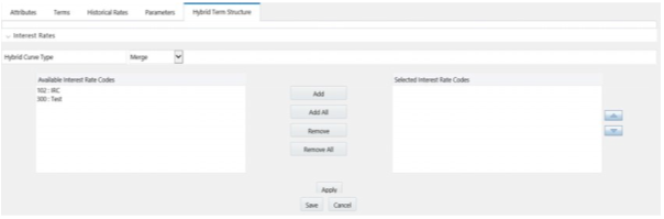

Figure 10-9 Hybrid Curve tab on Interest Rate Code window
The Hybrid Curve tab on the Interest Rate Code window allows you to specify three hybrid yield curves namely, Spread, Moving Average, and Merge.
Hybrid Curve Type: :
  • Spread: A Spread hybrid yield curve is defined as the difference between two standard yield curves. The Spread type of hybrid yield curve is useful in establishing liquidity risk or basis risk yield curves.
  • Moving Average: Moving average hybrid yield curves represent moving average data of a single underlying standard yield curve. These curves are used in Funds Transfer Pricing.
  • Merge: Merge hybrid yield curves represent a blending of two or more underlying yield curves. In constructing a Merge type of hybrid yield curve, specify the percentage weighting applied to each of the underlying standard hybrid yield curves.
  • Minimum: The Minimum hybrid yield curve is defined as the minimum between two standard yield curves.
  • Maximum: The Maximum hybrid yield curve is defined as the maximum between two standard yield curves.
  • Custom Weighted Average: Allows to accept weights as input. Here, Effective dates are listed for the term point with maximum historical period over which average need to be calculated. For term points where historical dates are not applicable, you cannot enter weights. The default weight values are zero. Following formula is used to calculate Hybrid Curve Rate for each effective date in historical period = (Weight * Rate) / Total Weight. For more information, see Defining Custom Weighted Average section.
