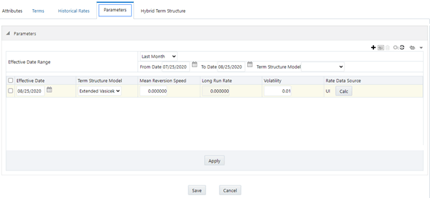

Figure 10-8 Parameters Tab on Interest Rate Code window
The Parameters tab on the Interest Rate Code window allows you to calculate parameters for any Term Structure Model for a given Effective Date, based on your relative look back term and a sufficient number of observations (available historical rates) for the IRC.
To edit or recalculate the existing Parameters, enter the Effective Date Range filter.
  1. The following icons are available here:

  2. Default parameters for the Extended Vasicek Model are displayed for one Effective Date (the System Date on which the Interest Rate Code was created). You can edit these parameters or add new parameters using Add. Use the Refresh to return to existing Parameters.
    Steps 3 and 4 are applicable only if you are Adding or Editing Parameters.
    To add or edit the parameters, use the Data Input Helper or Excel Import or Export. For more information, see the Excel Import or Export and Data Loader sections.
  3. Enter the Effective Date. Note that the Effective Date cannot be greater than the Current System Date.
  4. Select the Model from the Term Structure Model drop-down list. Effective Date and Term Structure Model combination must be unique within this IRC.

  8. The Rate Data Source indicates if you have directly entered Parameters through the UI. You can calculate the Parameters to display system-generated values.
  9. Select Calculate to view the Term Structures Parameter Estimation window.
  10. If you are directly entering the Parameters, then enter values appropriate to the Model, then click Apply else click Calculate.
  11. The End Date is auto-populated with the Effective Date. Enter the Relative Term with Multiplier to define the rate look-back period.
  12. The Term or Multiplier value must be at least 300 Days.
  13. The Start Date is automatically updated after entering a Relative Term.
  14. Click Calculate Number of Observations to confirm the number of rates found for appropriate dates within the Relative Term. If there are at least 10 observations, then the Estimate option will become active.
  15. Click Estimate to calculate the parameters and store them in the Historical Parameters table (FSI_IRC_TS_PARAM_HIST). A confirmation message is displayed. Click Ok. The calculation will complete and you will be directed back to the Parameters tab.
