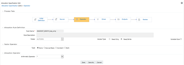

The Operator process tab allows you to specify how Source data and Driver data interact to create results.
- Operator Process Tab for Constant Rules: No Driver is necessary to specify a Constant rule. Both the Operator process tab and the Driver process tab are disabled for the Constant rule type.
- Operator Process Tab for Static Driver Rules: For Static
Driver rules, the Driver process tab is disabled, but the Operator process tab is
enabled to allow you to specify a static driver balance. Static amounts are entered
into the Factor Operator pane.
Figure 15-16 Allocation Specification - Operator Process tab
- Operator Process Tab for All Other Rule Types: For all other rule types, the Operator process tab offers both a Factor Operator and an Allocation Operator. The Allocation Operator links the Allocation rule's Source Data with its Driver data. The Factor Operators may be interposed between the Source and Driver.
