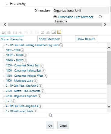

The default for each dimension is <All> (meaning no constraint). To select a constraint, click on the Hierarchy Browser ellipses (…) next to the dimension you wish to constrain.
Figure 15-13 Hierarchy Definition for Organization Unit Dimension Type
The Hierarchy Browser defaults to a list of leaves for the dimension you have chosen (the radio button selector near the top of the browser window defaults to Dimension Leaf Member). You may scroll up and down to find the leaf member you want or you may search for the member's name (short description) using the binoculars icon on the browser window.
The Hierarchy Browser defaults to a list of leaves for the dimension you have chosen (the radio button selector near the top of the browser window defaults to Dimension Leaf Member). You may scroll up and down to find the leaf member you want or you may search for the member's name (short description) using the binoculars icon on the browser window. Additional search functionality is provided by the Search icon. This additional functionality allows you to search by Dimension Member, Name, or Code.

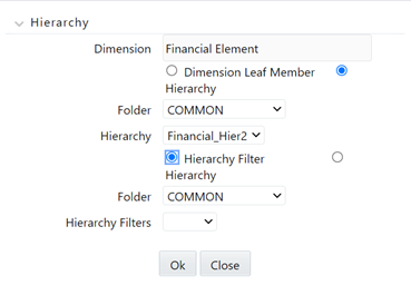

To constrain your source using a hierarchy rollup point, click Hierarchy, and search for the hierarchy you wish to use. After your chosen hierarchy is displayed within the browser window, navigate to the hierarchy until you have found the rollup point or leaf value you want. Select the value and click OK.
Figure 15-15 Hierarchy Definition
After your have chosen hierarchy is displayed within the browser window, navigate to the hierarchy until you find the rollup point or leaf value you want. Select value and click OK.
To constrain your source using a Hierarchy Filter, select Hierarchy, and search for the type that supports the Hierarchy Filter you wish to use. Click Hierarchy Filter, search for the filter type you wish to use and click OK.
