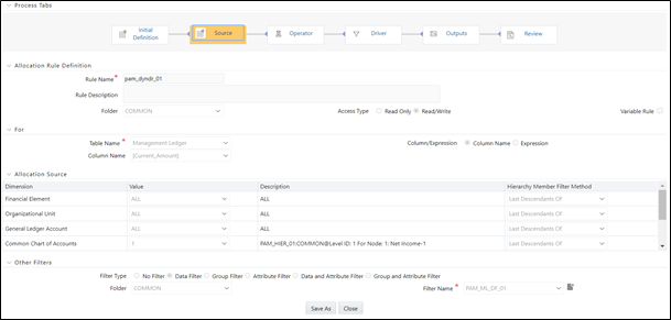

The Allocation Source pane is used to provide dimensional constraints on your Source data. For any dimension, you may constrain your source data by selecting a leaf member, a roll-up member within a Hierarchy, or a Hierarchy Filter.
At least one leaf-level dimension member is required for hierarchies used in allocations.
For allocation rules that source data from the Management Ledger-level, you must select a Source scenario from the Allocation Source pane. The default for new allocation rules is <Use Application Preferences>. When you use this default value, the Scenario (also called Consolidation Code) is determined by the value that is set in Application Preferences for Profitability Management for the user who is running the rule. If you do not select <Use Application Preferences>, you must select a defined dimension member value (for example, Actual, Budget, Forecast, Forecast Prior). These values are provided with the data model, but you may add additional dimension members in the Consolidation Code dimension.

Figure 15-12 Allocation Source Pane

The dimensions listed in the Allocation Source pane are limited to your Key Processing Dimensions. The seeded key processing dimensions for all OFS analytical application are:
  • Financial Element
  • Organizational Unit
  • General Ledger Account
  • Common Chart of Accounts
  • Legal Entity Product
You may add your Key Processing Dimensions (see the OFS Analytical Applications Infrastructure Installation Guide for how to add processing dimensions). If you have enabled multi-currency, the Currency dimension is also displayed. For details on multi-currency calculations within Profitability Management, see Multi-Currency across OFSAA Applications.
