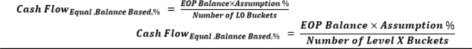

    1. EOP Balance Based Assumptions, Assumption Unit = Percentage
      Image81 This illustration shows the calculation for EOP Balance Based Assumptions,
      Figure 7-20 Calculation for EOP Balance Based Assumptions
      Where,
      Level X Buckets: Higher granular buckets
      Table 7-49 Equal Assignment under Balance Based Assumptions, %
      Business Assumption Cash Flow Assignment
      Product From Bucket Run-off Contractual Cash Flow Time Bucket Business AssumptionsRevised Cash Flow
      Time Deposits 8-15 Days 5% 10000 Overnight – 2500 [= 10000 – {(500000*5%)/2}]
            5000 1-7 Days – 7500 [= 5000 – {(500000*5%)/2}]

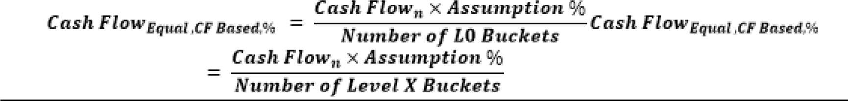

    2. Cash Flow Based Assumptions, Assumption Unit = Percentage
      image82 This illustration shows the formula for Cash Flow based Assumptions.
      Figure 7-21 Formula for Cash Flow based Assumptions
      Where, n: Selected bucket
      Table 7-50 Equal Assignment under Cash Flow Based Assumptions, %
      Product Time Bucket Run-off Contractual Cash Flow Time Bucket Revised Cash Flow
      Time Deposits 8-15 Days 5% 10000 Overnight 9800 [= 10000 – {(8000*5%)/2}]
            5000 1-7 Days 4800 [= 5000 – {(8000*5%)/2}]

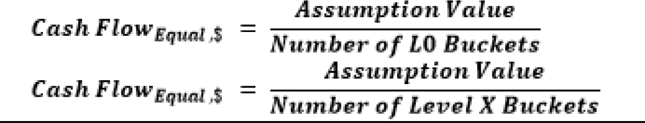

    3. Assumption Unit = Value
      Figure 7-22 Formula for Assumption unit.
      This illustration shows the formula for Assumption unit.
      Table 7-51 Equal Assignment, Value
      Time Deposits 8-15 Days 3000 10000 Overnight 8500
            5000 1-7 Days 3500 [= 5000 – (3000/2)]

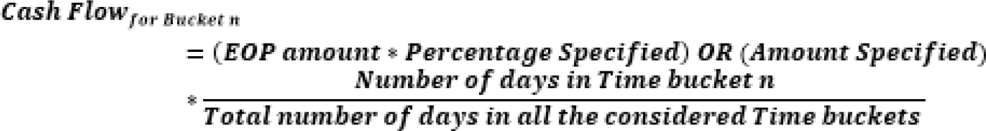

  3. Proportionate Assignment
    Cash flows are assigned to each bucket up to the selected bucket in proportion to the bucket size. Assignments are made proportionately to the selected level and further assignment is done till the most granular level. The formulae under different conditions are as follows:
      Figure 7-23 Formula for EOP Balance Based Assumptions.
      This illustration shows the formula for EOP Balance Based Assumptions.
      Where,
      t: Number of days in the given Level X bucket
      Table 7-52 Proportionate Assignment under Balance Based Assumptions, %
      T: Total number of days up to the selected bucket Cash Flow Assignment
      Time 8-15 Days 5% 10000 Overnight 10000
      Deposits [= 10000 –
        {(500000*5%)*0/7]
            5000 1-7 Days – 20000
      [= 5000 –
      {(500000*5%)*7/7]

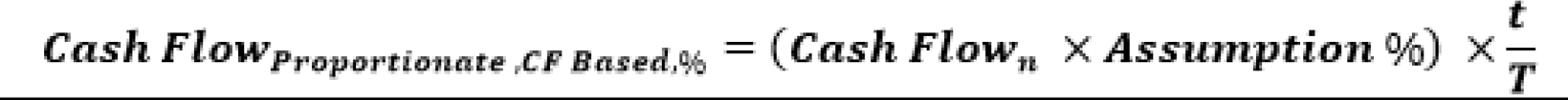

      Figure 7-24 Formula for Cash Flow Based Assumptions.
      This illustration shows the formula for Cash Flow Based Assumptions.
      Table 7-53 Proportionate Assignment under Cash Flow Based Assumptions, %

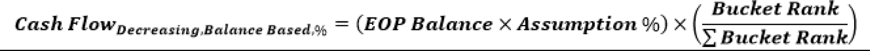

  4. Decreasing Assignment
    Cash flows are assigned to each bucket up to the selected bucket in decreasing order based on ranks assigned to cash flows. Assignments are made in decreasing order to the selected level and further assignment is done till the most granular level. The formulae under different conditions are as follows:
      Figure 7-25 Formula for EOP Balance Based Assumptions.
      Where,
      Bucket Rank: This is the rank assigned to each Level X bucket within the bucket set. The rank is assigned in decreasing order that is, 1 is assigned to the last bucket in the set, 2 is assigned to the previous bucket, and so on.
      Table 7-55 Decreasing Assignment under Balance Based Assumptions, %
      Product Time Bucket Run-off Contractual Cash Flow Time Bucket Bucket Rank Revised Cash Flow
      Time Deposits 1-3 Months 5% 10000 Overnight 4 0 [= 10000 – (500000*5%)*4/10]

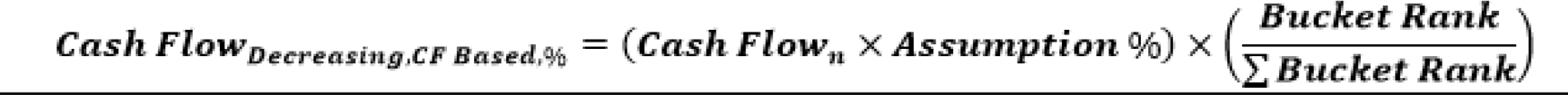

      Figure 7-26 Formula for Cash Flow Based Assumptions.
      Table 7-56 Decreasing Assignment under Cash Flow Based Assumptions, %
      Time Deposits 1-3 Months 5% 10000 Overnight 4 9880 [= 10000 – (6000*5%)*4/10]
            5000 1-7 Days 3 4910 [= 5000 – (6000*5%)*3/10]
            8000 8-15 Days 2 7940 [= 8000 – (6000*5%)*2/10]
            3000 16-30 Days 1 2970 [= 3000 – (6000*5%)*1/10]

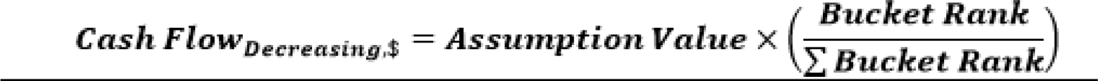

      Figure 7-27 Decreasing Assignment, Value
      Table 7-57 Decreasing Assignment, Value
      Time Deposits 1-3 Months 5% 10000 Overnight 4 8800 [= 10000 – (3000*4/10)]

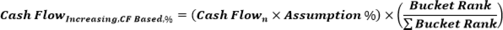

      Figure 7-29 Formula for calculation of cash flows.
      This illustration shows the formula for calculation of cash flows.
      Table 7-59 Increasing Assignment under Cash Flow Based Assumptions, %
      Time 8-15 Days 5% 10000 Overnight 1 9866.67

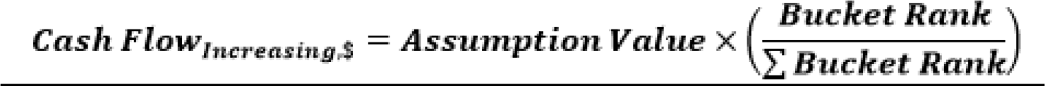

      Figure 7-30 Formula for calculation of cash flows.
      Table 7-60 Increasing Assignment, Value
      Time Deposits 8-15 Days 3000 10000 Overnight 1 9000
            5000 1-7 Days 2 (3000*2/3)]

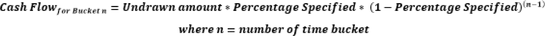

  6. New Business
    End of Period (EOP) Asset Balance of Growth assumption allows you to select the method for cash flow assignment. Various options for cash flow assignment available are as follows:
    • Decreasing: In decreasing order to all time buckets up to and including the selected time bucket.
    • Equal: Equally to all time buckets up to and including the selected time bucket.
    • Proportional: In proportion to the time bucket size.
    • Selected: Selected time bucket only.
    Decreasing Cash Flow assignment is done using the following formula:
    Figure 7-31 Formula for calculation of cash flows.
    Equal cash Flow assignment is done using the following formula:
    Figure 7-32 Formula for calculation of cash flows.

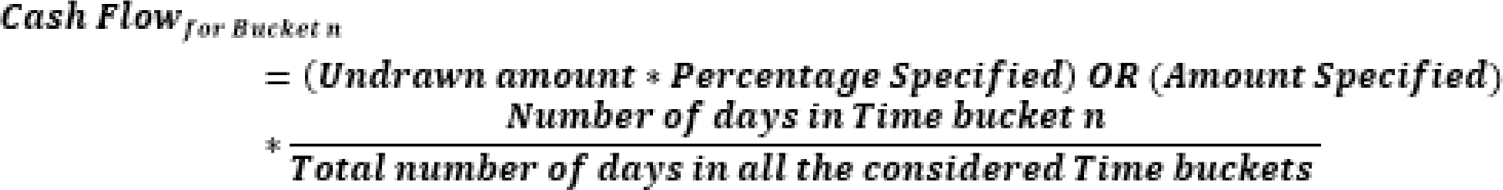

    Proportional Cash Flow assignment is done using the following formula:
    Figure 7-33 Formula for calculation of cash flows.
    Selected Cash Flow assignment is done using the following formula:
    Figure 7-34 Formula for calculation of cash flows.

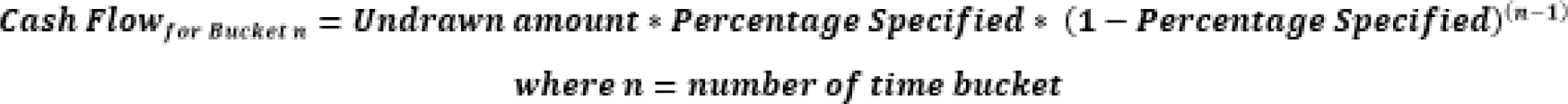

    EOP Liability Balance Growth assumption allows you to select the method for cash flow assignment. Available options for cash flow assignment are as follows:
    Figure 7-35 Formula for calculation of cash flows.
    Equal Cash Flow assignment is done using the following formula:
    Figure 7-36 Formula for calculation of cash flows.
    Figure 7-37 Formula for calculation of cash flows.
    Figure 7-38 Formula for calculation of cash flows.
    Figure 7-41 Formula for calculation of cash flows.
