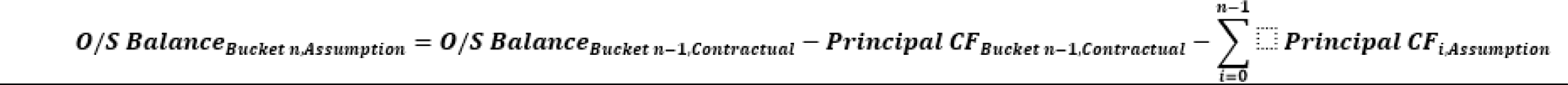

  5. Calculate the outstanding balance in each bucket under business-as-usual or stress terms. The outstanding balance in the first time bucket will be the EOP balance. The formula for calculating the outstanding balance for each subsequent bucket is as follows:
    Figure 7-18 Formula for calculating the outstanding balance
    This illustration shows the formula for calculating the outstanding balance for each subsequent bucket.

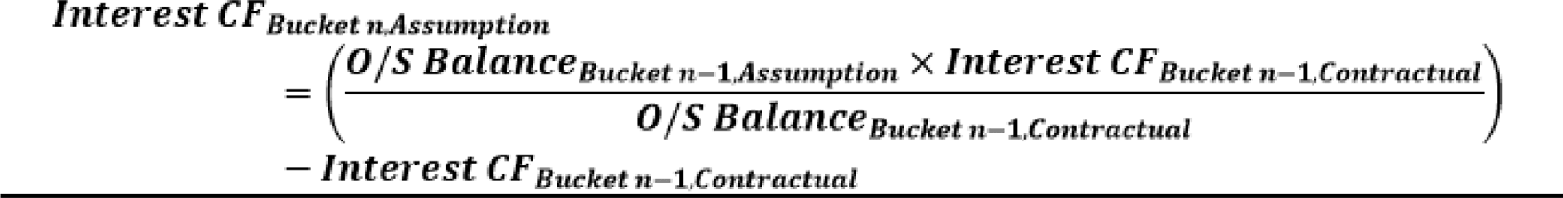

    Calculate the proportionate impact on interest cash flows in each bucket under business-as-usual or stress terms as per the following formula:

    Figure 7-19 Formula for the proportionate impact
    This illustration shows the formula for the proportionate impact on interest cash flows in each bucket under business-as-usual or stress terms
