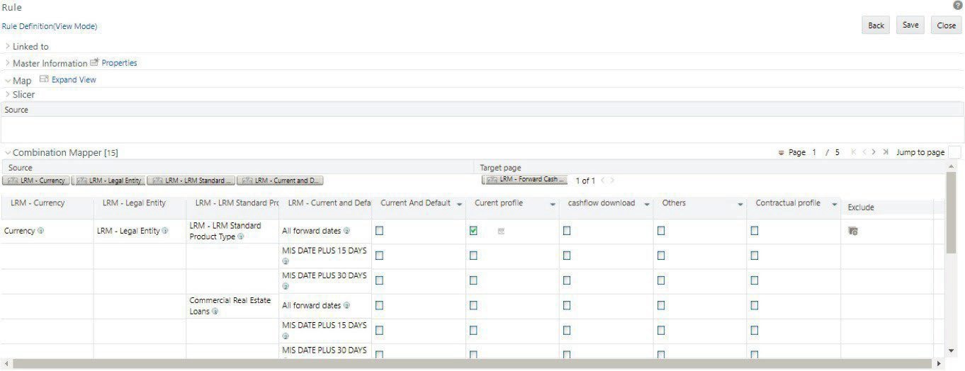

The additional Dimension – “LRM- Current and Default Method – Forecast” (Source hierarchy) must be selected when you wish to map the “Current and Default Profile” method to any of the dimensions (product, currency, and legal entity).

The additional Dimension – “LRM- Current and Default Method – Forecast” (Source hierarchy) must be selected to map the “Current and Default Profile” method to any of the dimensions (product, currency, and legal entity).
This hierarchy contains MIS Date plus the number of days that is mapped to Current and Default Profile.
Figure 16-12 Cash Flow Calculation
This illustration shows the number of days that is mapped to Current and Default Profile.
