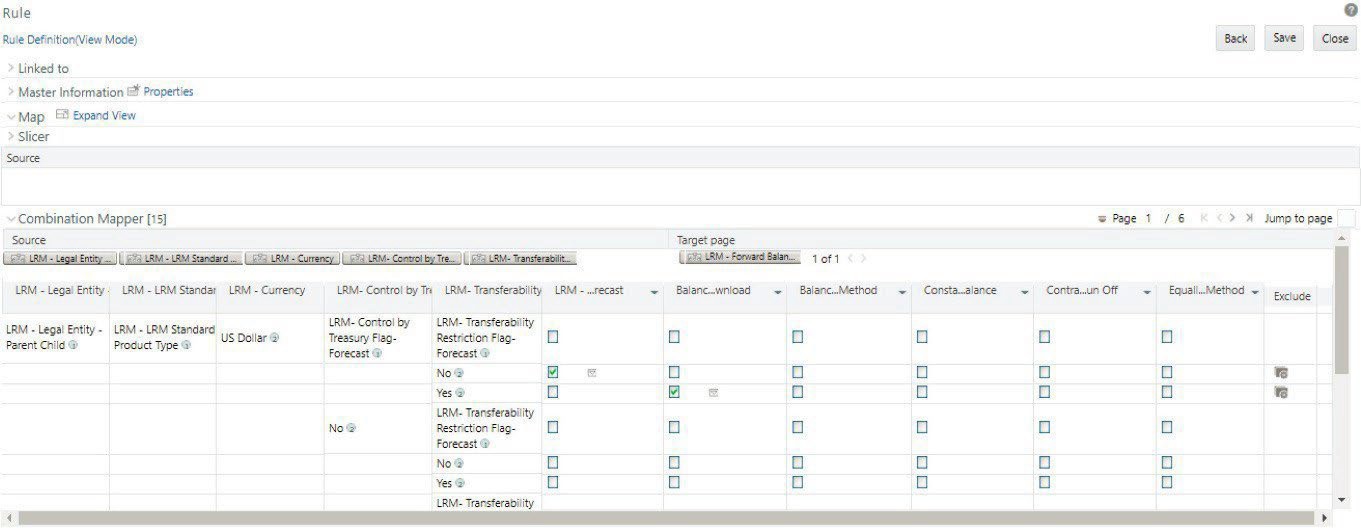

In the Run Definition window, Include Forward Date Calculations is selected as Yes and the Forward Balance Method Mapping Rule is selected as LRM – Balance Method Reclassification.
The Out of Box Rule name is “LRM - Balance Method Reclassification – Forecast”.
The Out of Box rule has sample mappings and it is expected to change the mapping as per the requirement The list of mandatory source dimensions for this rule is follows:
  • Standard Product Type
  • Legal Entity
  • Currency
  • Transferability Restriction
  • Control By Treasury Flag.
These are mapped to the target dimension “Forward Balance Method Type”. For Balance Calculation, the following methods are available in the application. To view the methods in the Run Definition window, navigate to the Liquidity Risk Management, select Manage LRM Rules, select Rule then select Run Definition window.

Figure 16-13 Balance Calculation
This illustration shows the balance calculation
